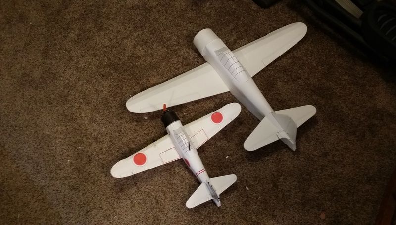

The first photo is soo cute!
What is the percentage of the large Zero in relation to the small Zero?

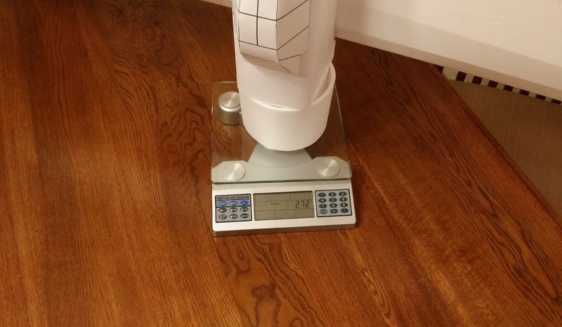

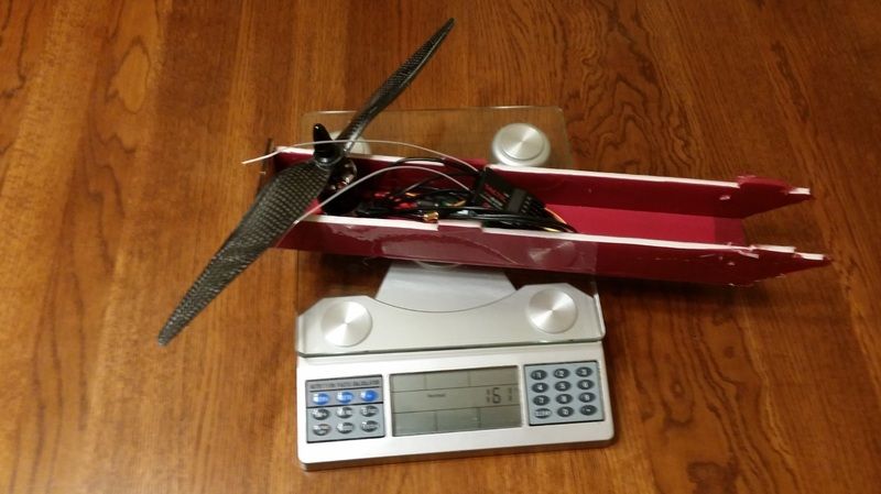

Some weight calculation:
If I add a bit more weight finishing off the build I imagine it'll come in around 625 grams, maybe a bit less. Plan on using a Tiger 2216-9 1100kv motor, 30a ESC, maybe an 11x6 carbon prop that's in the picture - need to check motor specs again, and 2200mah battery. Good news is that all of that balances out just fine before adding landing gear - tail heaviness shouldn't be a problem with this bigger model.
