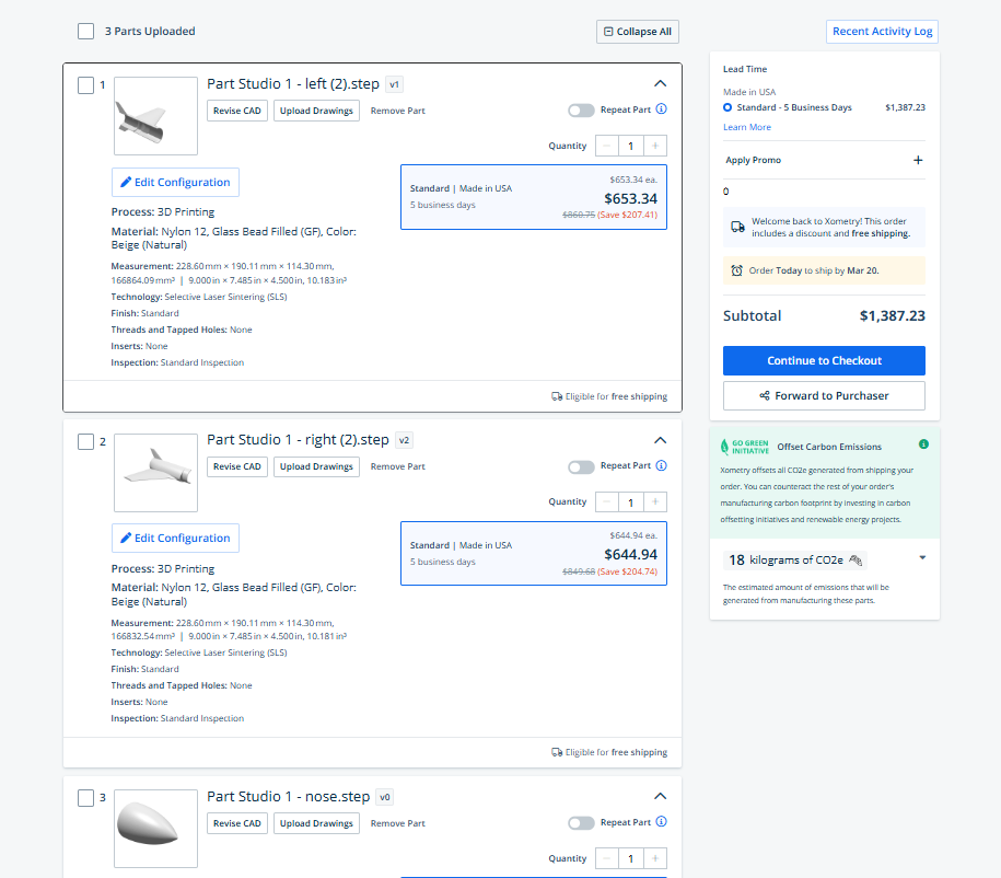

maybe. Im checking Xometry to see how much it would cost to get it SLS printed in glass filled nylon. I split it so the nose is separate and the fuselage is halved so i could do that.
HOLY
ezbruh
i think my best bet is 3d printing some formers and negatives and making it out of fiberglass composite. waaaaay cheaper and still very light and strong but fiberglass dust is scary.
