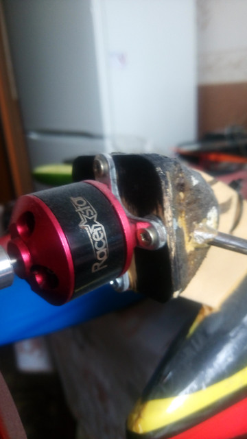

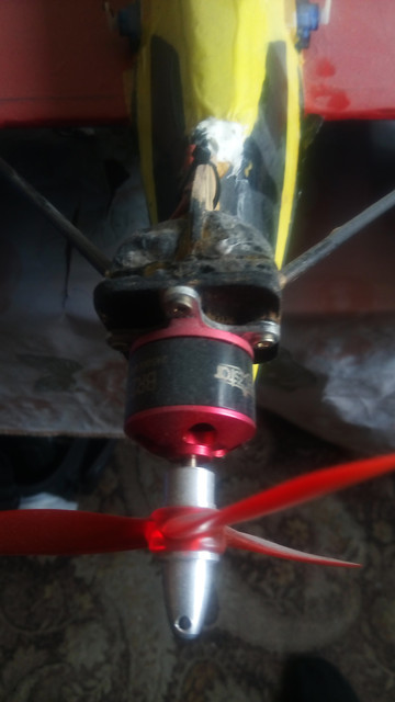

How is your motor mounted to the firewall? If you have screws going through its metal 'X' mount into the wood (or through the wood into nuts on the other side), you can slip washers between the mount and the wood to angle it off.
To figure out which direction to angle the motor off, view your plane from behind and check which way the prop spins. If it spins clockwise, then your plane will want to roll counter-clockwise, point the motor off to the right, to balance it out. If the motor spins counter-clockwise, the plane will want to roll clockwise, point the motor off to the left to balance it out.
This takes a lot of the rudder management work out, as increasing the throttle now not only increases the torque roll but also increases the yaw-thrust that balances it out. It won't be perfect, but it will make it much easier.
A bit of down thrust can be helpful too. This is simply the case of angling your motor down a bit. Use the same washer technique that you used to angle it off left or right.

For the down right thrust you need to tilt the motor. Normally the power pods are designed that they have the correct thrust angle. If you want to do that manually you need to put a washer under the screw with wich the motor is fixed to the fire wall on the opposite side of the thrust angle you want to achieve (if you want to add right thrust angle add the washer one the left side).
