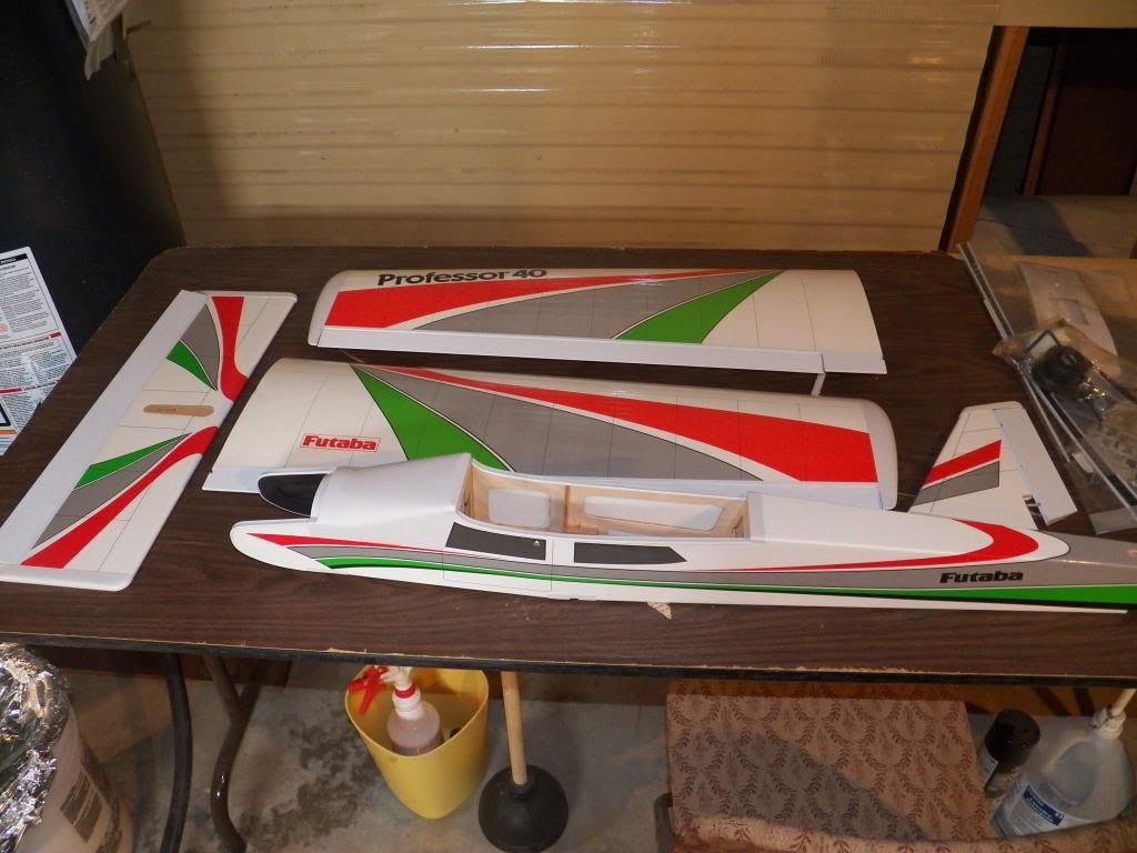

Hello,
I am building a 20 year old, new in box futaba professor 40 ARF nitro plane,
i have all i need, but not the instruction manual.
I have contacted futaba and may or may not get a manual, but i have other questions
What glue should i use? its balsa with some foam.. and if im stuck can i post some pics and get help? thanks,
Isaac

If your time is "unlimited" - use aliphatic glue. White wood glue. It is strong and not brittle and will not get miscolored after a shoort time like many epoxi glues.
Epoxi is used for firewall, motor mounts and conecting the wing halves if any.
You will most certainly get the advice to use the fast "super glue" from some builders.
The CA will normally get brittle when old.
Both epoxy and CA are bad for your health but used with plenty of ventilation and gloves Ok and needed if you are in a hurry.
I have never seen or heard of the Futaba Professor before - please post some pictures of your plane.
It is most possible a plane sold under other names.
