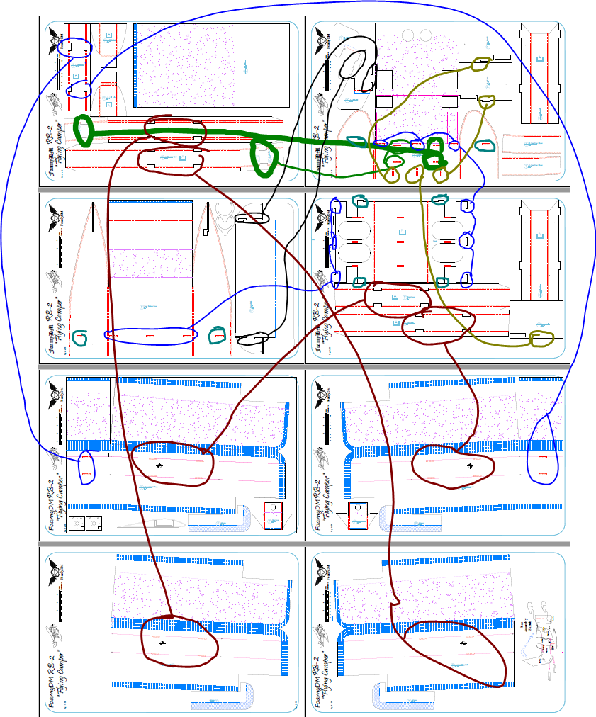

I think you just did a great job of labeling them here! :ROFLMAO::ROFLMAO:
I even included a 3d assembly drawing.
I thought you accidentally posted your boyscout troops football play book.
Close, My guys are Cub scouts - much younger. You can tell because the lines wiggle and cross more, Lastly I goofed, the plan I posted with the colored lines are the plan for flag retirement ceremony, :p
or was it the smurf's panic plan:unsure::
I'll post the real RB-2 Plan assembly key later.:LOL:
