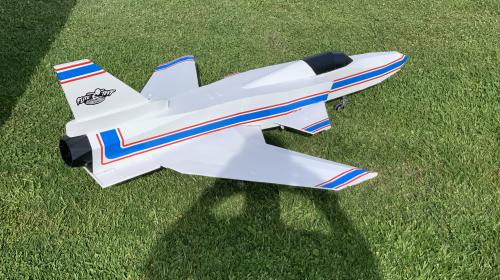

dhall224
Wow that's Beautiful and a lot of work! What covering did you use? Did you make the graphics? View attachment 241282
Yes, I like X-29's.... I scratch built that one from AMA plans in 1989. It went through 3 glo engines and now has 6s electric conversion. I have a FT X-29 with 70mm EDF and I scratch built one blowing it up 125% with 90mm EDF and adding removable wing, retracts, rear elevator and I can't remember what else. See my article here....
