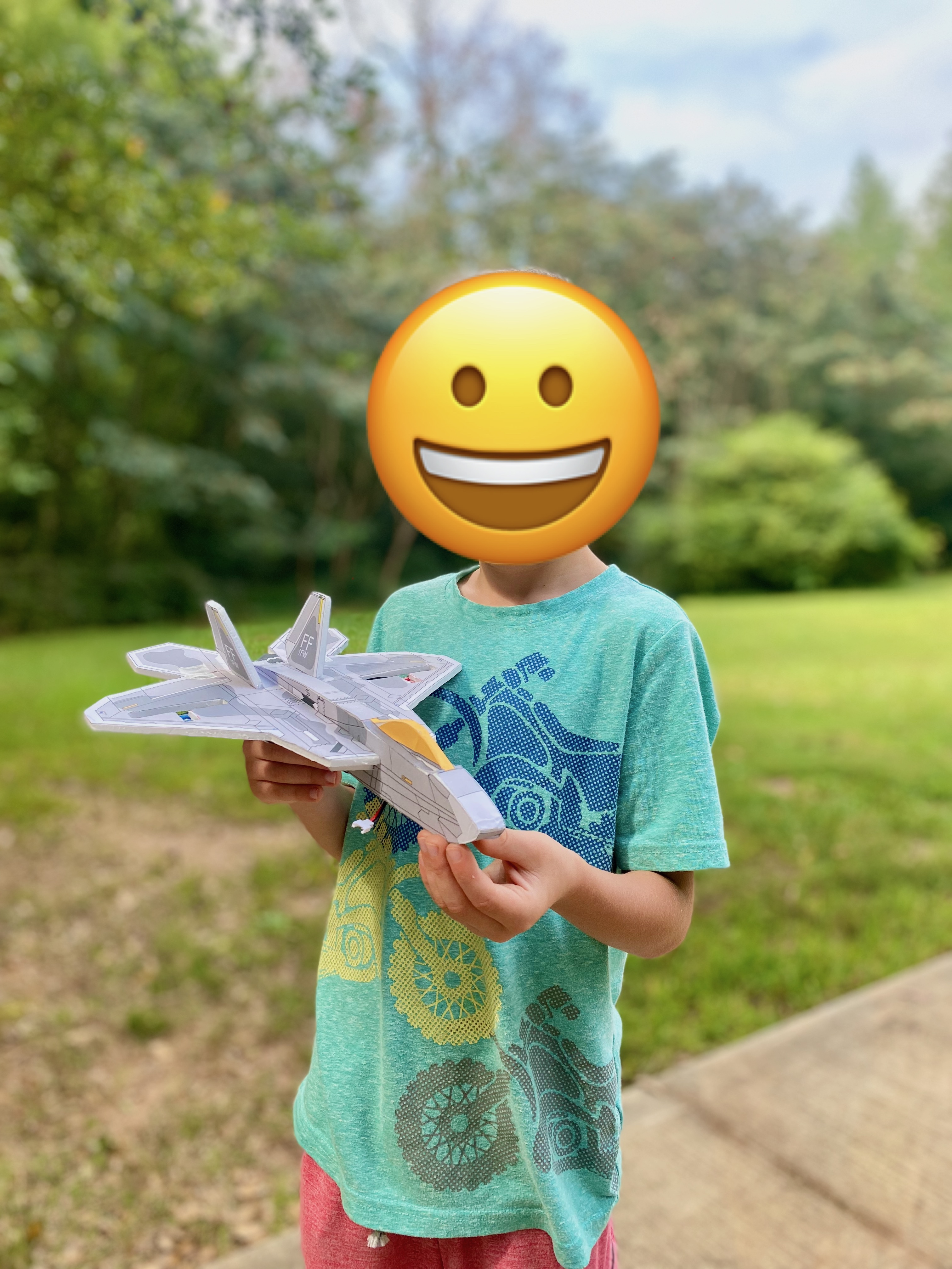

@AIRFORGE thank you for the plans, we've got a very happy 6 y/o over here! He used his own money to buy the Readi-Board and was thrilled it could be built immediately without waiting for a kit to ship from FT. @GrizWiz thank you for the skins, that really makes this a fun build for kids!

On the one we just built, I peeled off all paper and used a very light mist of Super 77 to apply the skins. We printed them on standard weight paper. We’re using the EZ Pack v2 and it flies great. It is actually the fastest EZ plane we have built so far. For only $21 worth of supplies, you can’t beat it!

Based on the suggestions above, i ordered an upgraded v2 power pack (actually two, one for me and one for my son). Printed out the tiled plans, and i was surprised just how tiny this is - looks like only a 10" wingspan. I am a little confused by the mounting of the RX and battery. There are several references to removing paper on the plans, but it is not clear to me if the RX and battery actually go in a cutout area within the 3-wide foam fuselage, or are mounted outside of it. I looked through the pictures on the thread and did not see any that showed how those items were mounted.

Yes it is tiny. ours came out at 10" wingspan too. We installed our RX in the center fuselage piece, hidden so that the skins are not interrupted on the outside pieces. I did cut out the bottom and mount the RX a little lower to make the switch and LED more easily accessible. I peeled all paper off to make ours as light as possible, and used a light mist of Super 77 to apply the skins. Some of the skins can be "pre-installed" but others are easier to do after it is assembled. Hope this helps!
