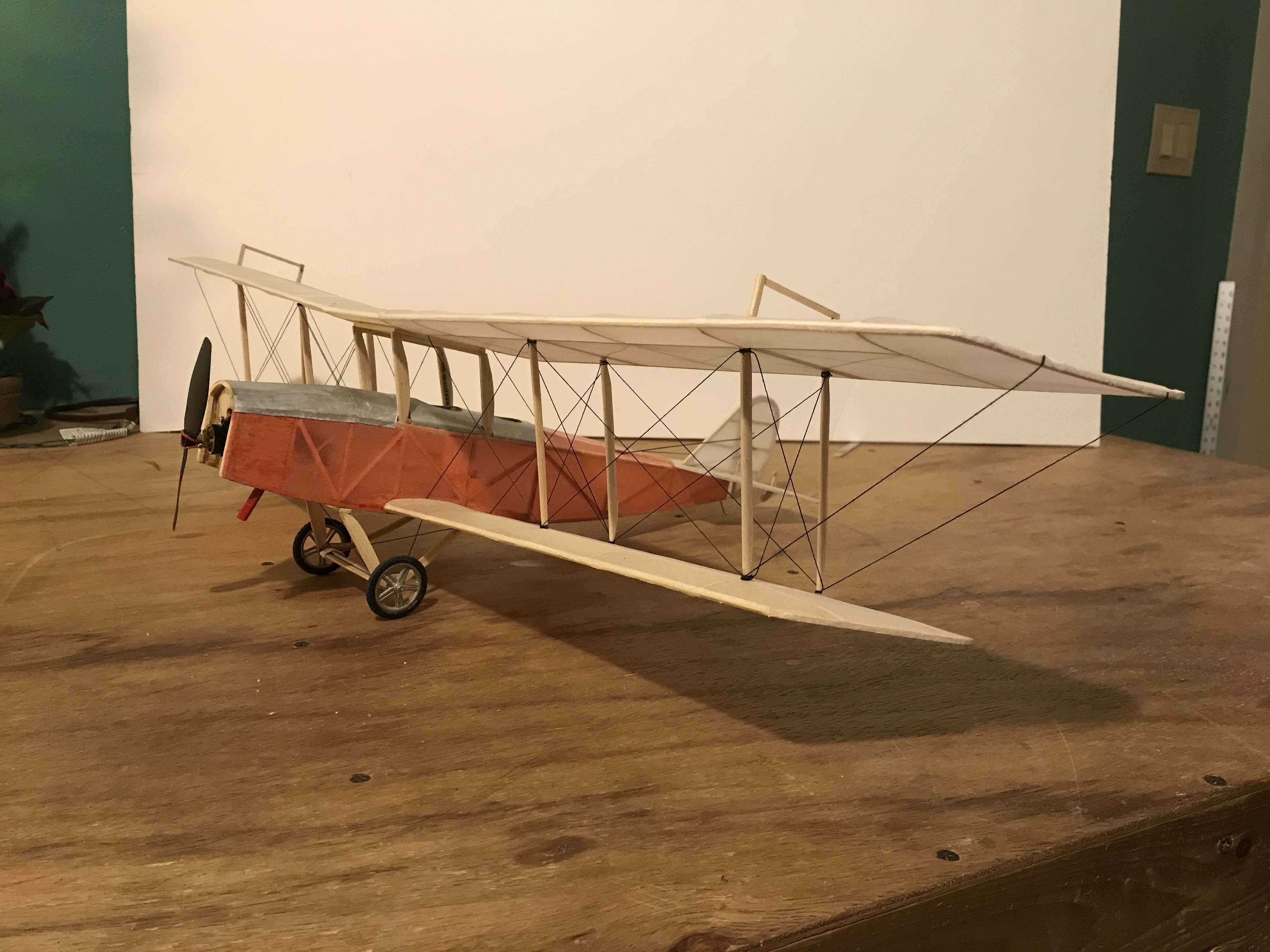

I just did flying wires on my little balsa Jenny with some black thread. Tied a clove hitch around each strut end and then hit it with a little CA glue.
Haven't flown it yet, but it was simple enough to do anyway. As long as you have solid struts it should work ok. If you had foam struts the thread would probably cut into them pretty quickly.
I've also seen elastic cord run through holes drilled in plywood struts. Your specific materials and size will affect which choices work for you.

Whoa...too cool:cool: Whacha used for covering? Tissue? If so, nice job(y)
