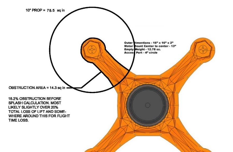

My major issue is how excessively large the booms are in planform.
If they are going to throw efficiency completely out the window, they should have considered dropping the motors deeper in the frame for protection, recessing them into a well. Keeping the pit slightly larger than the motor diameter for cooling. The boom thump is already going to be high, so who would care if the props were swinging an inch closer to the booms.
