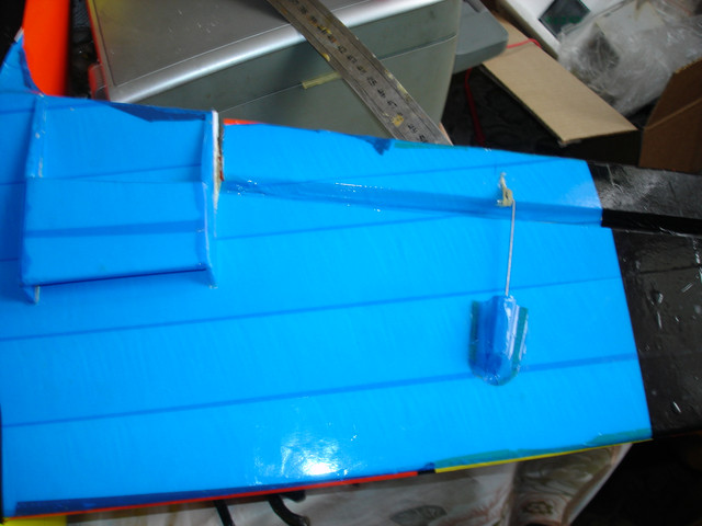

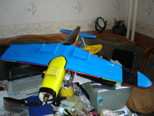

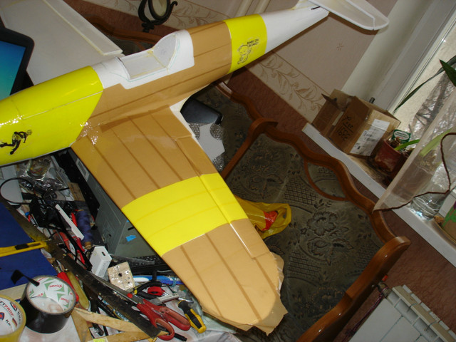

He began to wrap it with yellow tape. Tomorrow I will continue to cover with green tape. The bottom will be covered in blue. Black tape will be used too. I iron the whole tightness with a model iron.

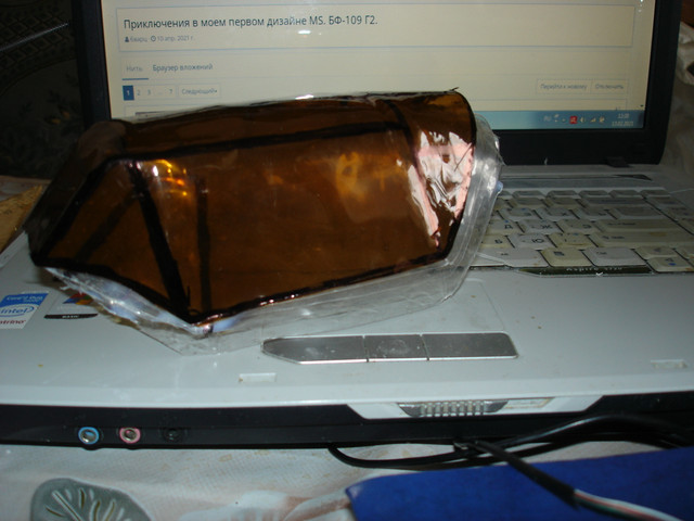

I do decals like this: I print out the image, cover it with transparent tape and iron it with a model iron. Then, under a stream of warm water, I gently peel off a layer of wet paper.The drawing remains on the transparent adhesive tape.

Я решилась на эту раскраску. Это будет не копия, а модель для духовных полетов. После подгонки вырежу и приклею остальные детали.
На другом авиамодельном сайте мою модель прозвали Мессершмитт Немо (как рыбка из мультика).

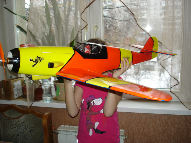

When gluing the motor frame, I immediately made a 3 degree slope to the right.The horizontal slope is 0.Will change when setting up after the first flight. The model pulls to the left - they say the engine is skewed to the right.as compensation for engine operation, or the curved geometry of the fuselage, rudder.Unfortunately, my daughter is ill and the trip to the village for the holidays is canceled, which means the flight of the model is postponed. I have ALL the models, after throws for planning and trimming, they fly like on rails.

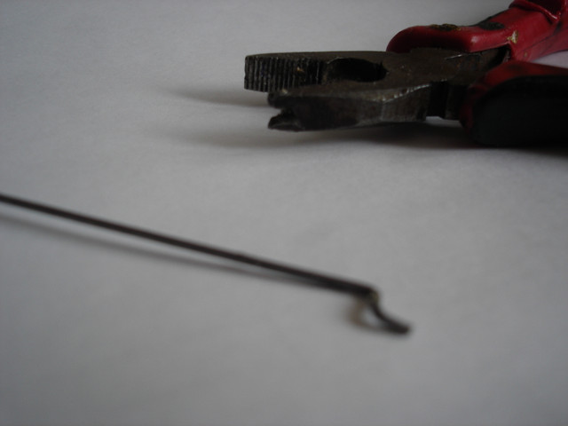

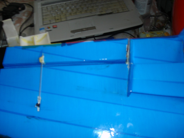

Today I did the control rods and connected the ailerons to the servos and the elevator.Finally glued the lantern. For precise bending of the rods, I made myself this tool -see the photo :
Tomorrow I will exhibit the final photos of the model before the flight. The remaining details of the decoration on the fuselage will be glued after the flyby .

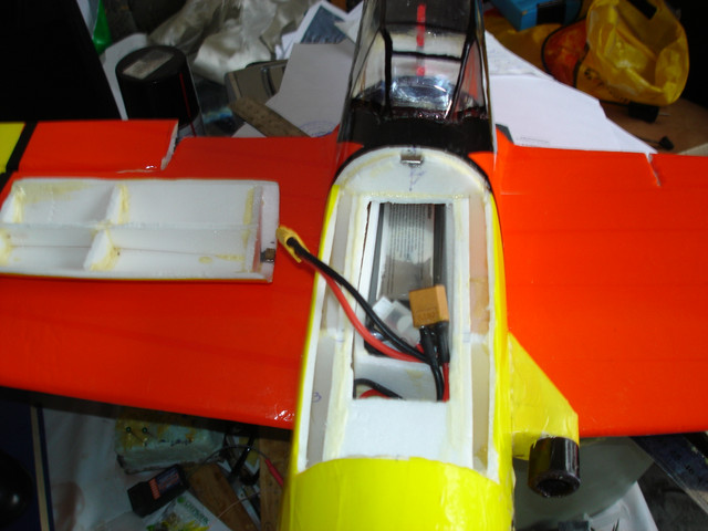

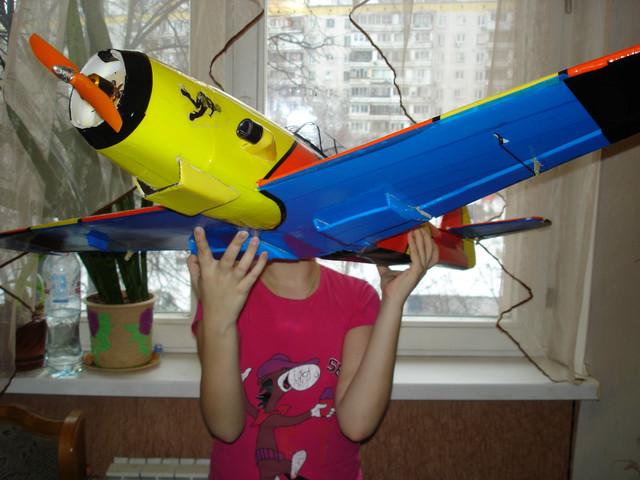

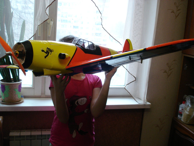

The photo shows the work done. The weight of the glider is 512 grams. The battery weight is 161 grams. The center of gravity is 25% of the wing chord.In the photo, the installation location of the container for the battery. All expenses on the transmitter for the flyby put 50%. It remains to get to the field in the village.My daughter has almost recovered and when she is discharged, we will go to the village.I will put up a video of the flyby not earlier than in a week.

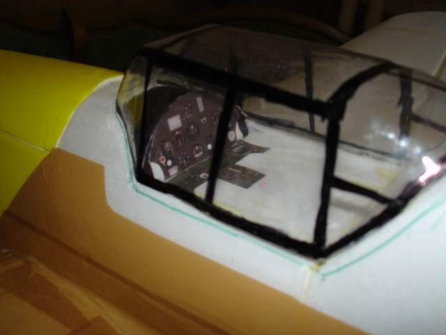

For those who want to make this model with a transparent cabin !!I can send 5 pieces of uncut lanterns in exchange for idle motors or regulators, unnecessary working servos.

"A rather sturdy master series build with a 46" wingspan". I made this model according to the author's drawing. Now I would change in the drawing : 1. I would not cut out the battery compartment in front of the cabin, but moved it under the hatch in front of the wing, like the FT P-51. 2. The tail frame reinforcement of the fuselage would be replaced by the FT P-51, which would make the tail part of the fuselage lighter while maintaining strength. 3. The wing licks must be made to the leading edge of the wing. 4. I did not make paper tunnels in the wing for wires -extra weight. In this model, after the flyby, I will try to fly with a 3S60C 1500mA battery, moving it to the nose of the fuselage. The goal is to reduce the flight weight of the model and compare flight quality. If everything is OK. Then the location of the hatch under the batteries will be justified.
