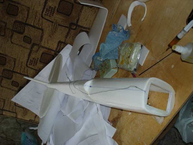

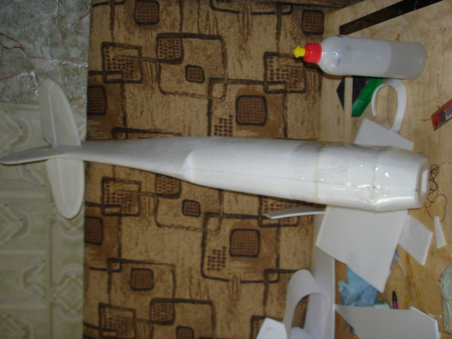

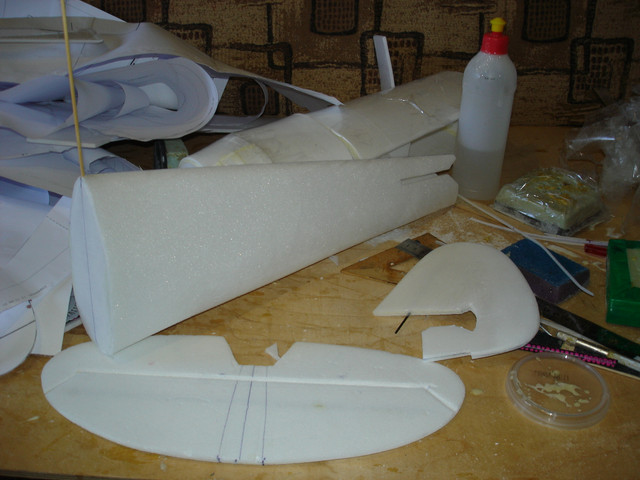

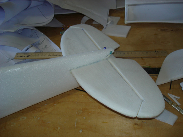

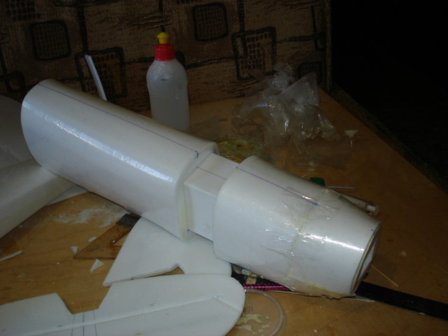

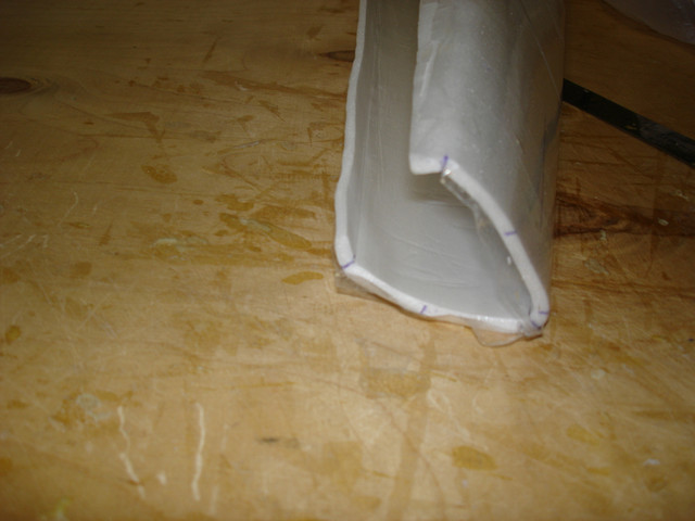

I started today with a tail detail .At the beginning, I placed the fold lines with a pencil. I began to form the lower edges on the edge of the plywood sheet : my wife warmed the foam bending place with a hairdryer and I bent it. The bottom edge was molded in 3 passes. Then I molded the middle on each side and then slowly made the molding of the center, periodically shouting (my wife sometimes warmed my fingers, not the foam). I'll glue it tomorrow. I did not cut out the tail reinforcement element - I did not understand its purpose : it is not connected to a single fuselage reinforcement structure.

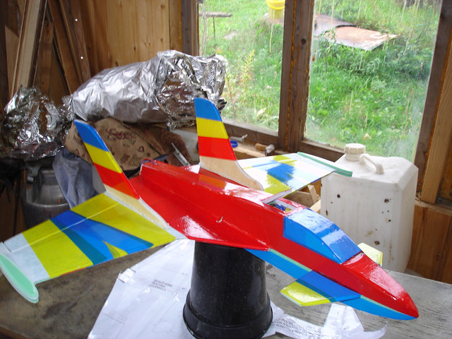

This is another material.I'm taking it here : https://alnado.ru/shop/komplektuyus...niya/penolist-dlya-modelirovaniya-belyj-5-mm/ . I cut the blank and cover with transparent tape. The material has flexibility in one direction and rigidity in the other direction. Heating with a hair dryer was done on the inside, Final finishing: heating with a hair dryer on the side with tape, 100 degrees on the hair dryer.I don't have 4S batteries, so I'm fighting for the weight of the model for my engine and 2200 mA 3S battery. The lightweight model flies well slowly and quickly. When performing a favorite figure by all modelers-a Carrot, the destruction of the model is more minimal. If I buy Flitetest material, then I will use it without paper -extra weight!!!Covering the model with colored tape with an iron gives fantastic strength. Tested by me on more than 40 models.I made this model 8 years ago. Foam with a thickness of 3 mm in one layer. Alive and flying great.

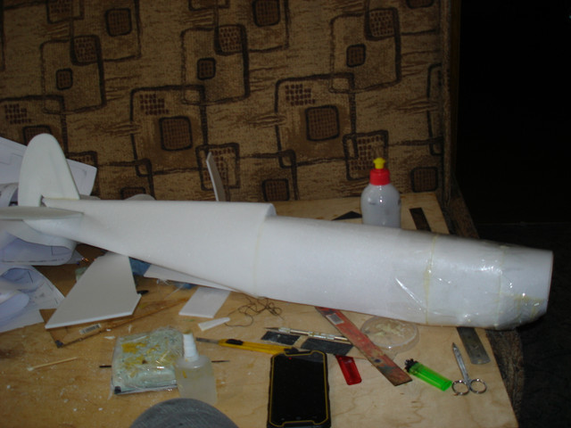

From 10 o 'clock in the morning until lunch , I worked fruitfully .The fuselage is ready. Now I'll get dressed and go to the Angler's shop for the tips of fishing rods. I'll take care of the wing tomorrow. Alas, one of the 3 servers turned out to be defective.We'll have to order and wait.This will be the elevator servo.

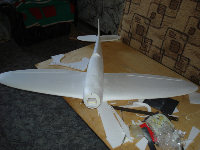

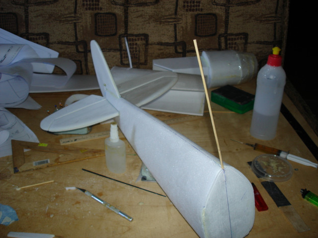

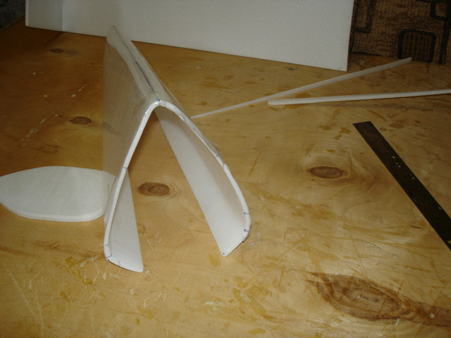

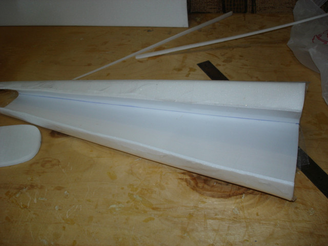

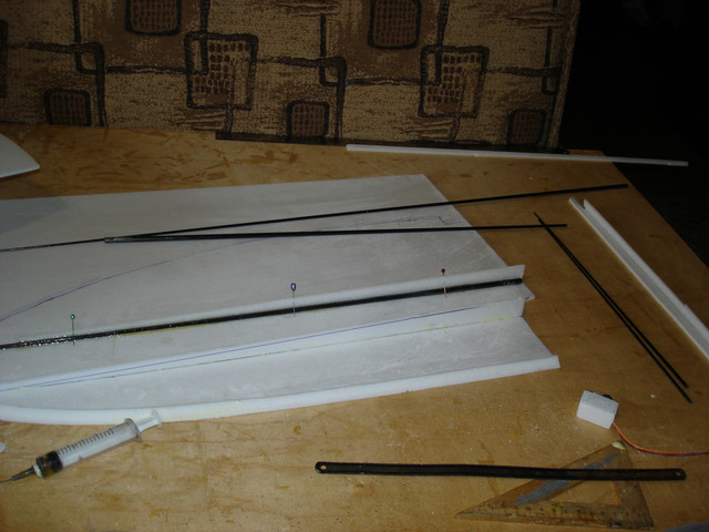

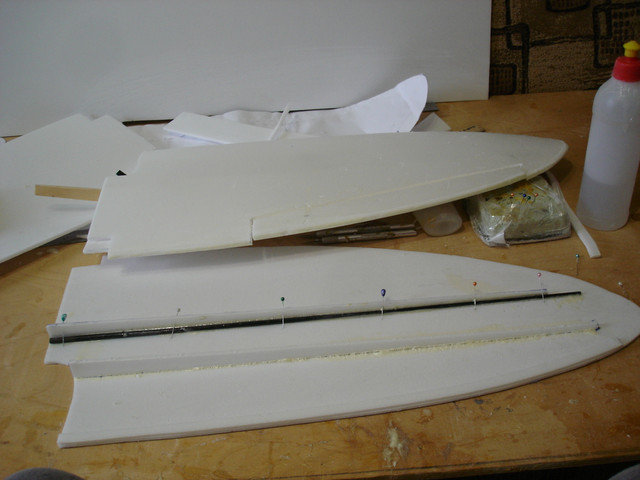

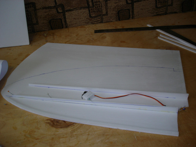

I started assembling the wing. This is a crucial part of the aircraft and I will not rush. I assemble all the wings according to the same scheme. I upload photos of the assembly. Tomorrow I'll seal the top of the wing and cut through the ailerons.True, I promised to look at and repair a neighbor for tomorrow (in Russia, neighbors and friends, and even acquaintances - for free) LG TV, matrix backlight stopped working.
In the photo, black spokes are my favorite tips for fishing rods from the Angler store, they cost $ 1, and how much strength for the wing and an excellent bowden for the elevator thrust.

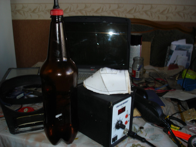

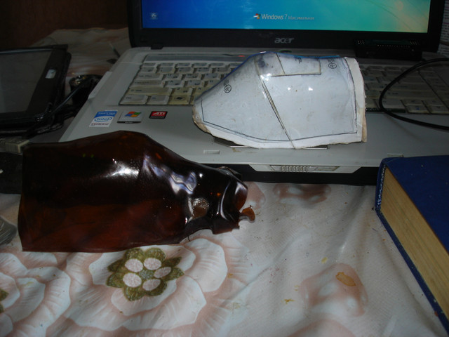

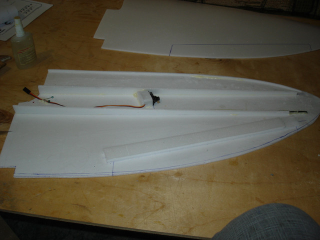

Carefully cut through the ailerons and half of the wing is ready. I'm going to glue the second half. I'm making a plaster cast for the cabin lamp.
