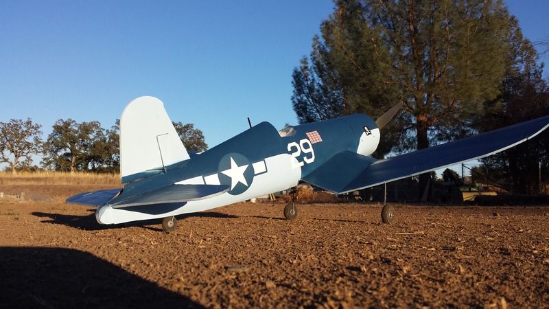

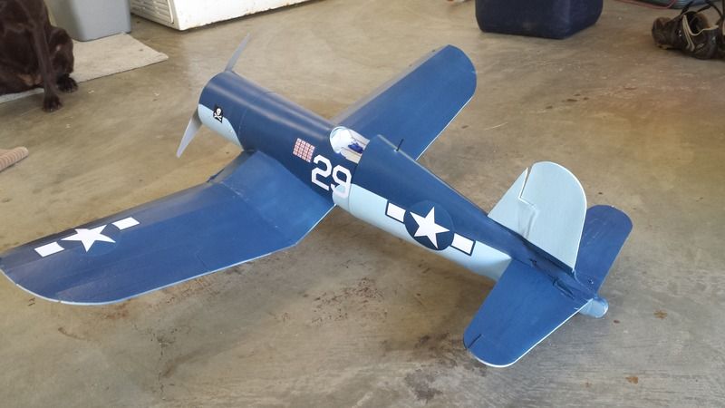

Here is my take on this corsair.
I made some mods to the original plans, including a bit thinner wing profile (closer to the spitfire one) and less dihedral.
Not finished yet, needs another coat of paint and stickers. The weather is not the best one right now to try it, but looking forward to the maiden!

Lookin good. I would think the thinner wing will make if fly a bit better. Don't get me wrong I love flying mine but it is a bit slow to react. Still trying to figure out my motor battery esc so I can get flights longer than 3 minutes. Also if u decided to do landing gear put it as far forward as u can. Mine has a tendency to flop over on its nose right before stopping.. it might be because I land on packed sand and it's bumpy. If I have 5- 13 mph winds I never do the nose flop though. Did u coat your cowl with something other than just paint? Sure looks smooth and shiny.
Pbarros
Junior Member
Yeah, when I saw that the profile was that thick decided to do something about it.
The ideia is to add retractable landing gear and will take that into account!
As for the cowl, added only some filler, since there were some defects from rounding it.

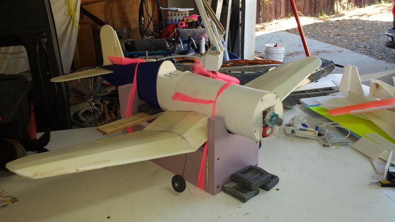

Very well done Pbarros. Looks like she performs nicely. I really enjoyed the one I built but unfortunately I lost orientation and crashed hard. Really not repairable. I just finished building a F6F Hellcat using the build technique alp uses for the Corsair. It turned out pretty nice including retracts. Will maiden her tomorrow. I will submit some photos soon.
