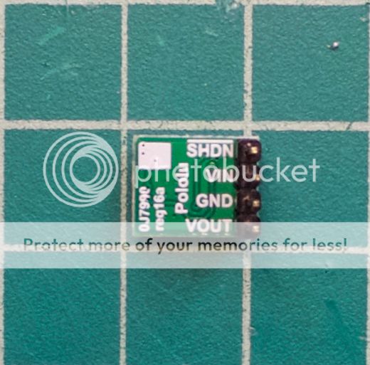

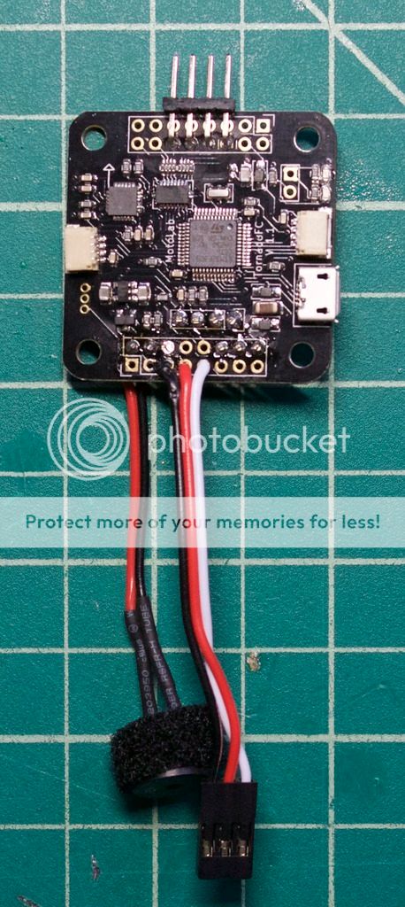

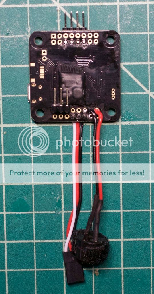

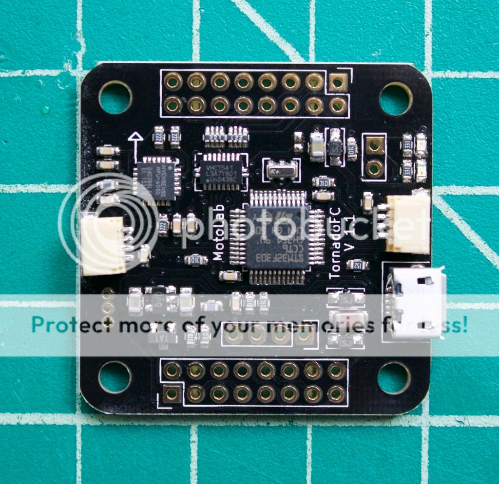

I'm using the MotoLab TornadoFC.

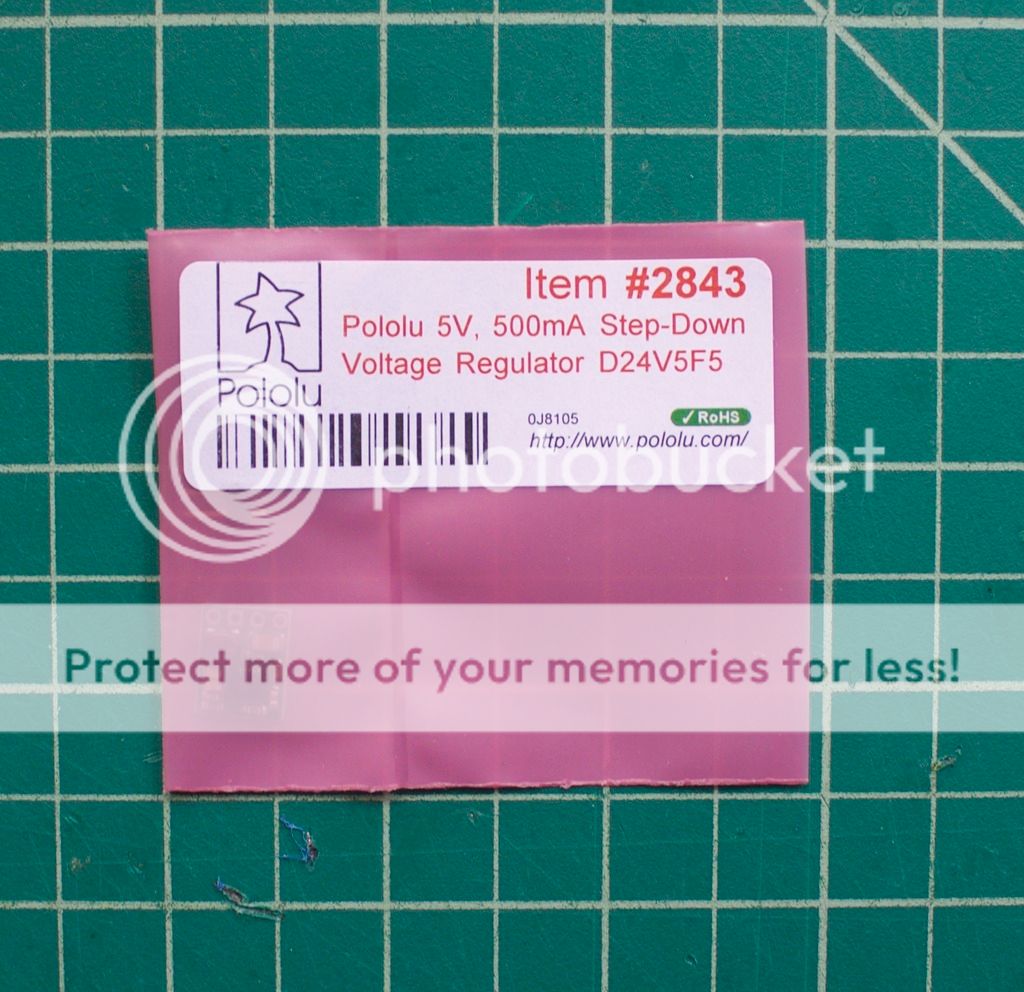

It has pins to solder a Pololu D24V5F5 directly to it.
After soldering on the Pololu, I added some pins, a buzzer, and a cable for the receiver.

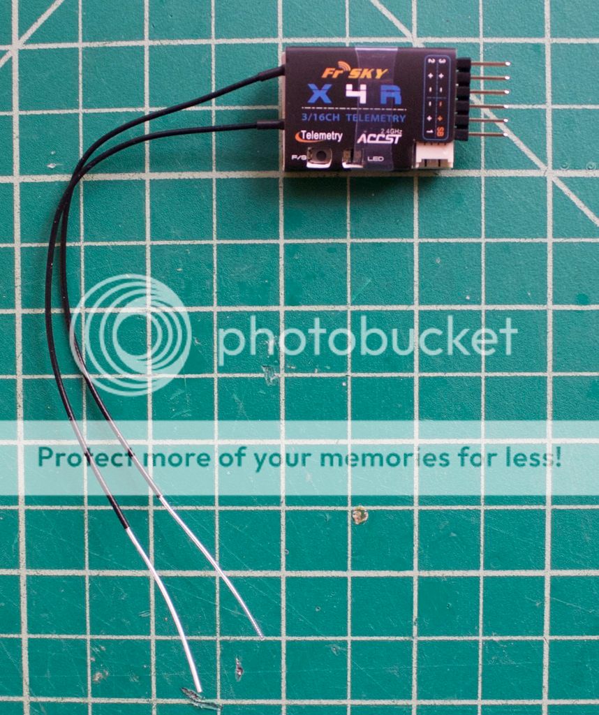

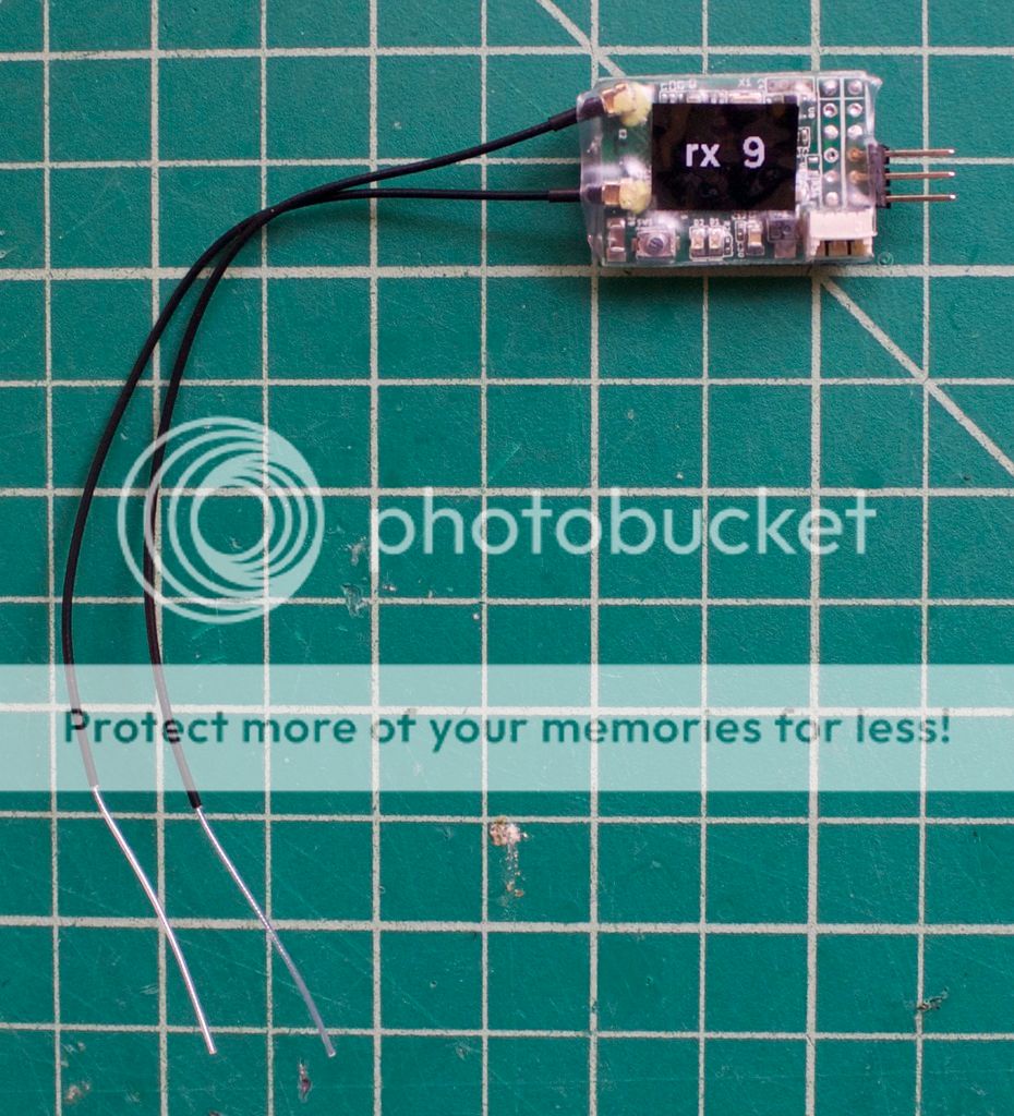

I'm using the X4R-SB rx.
I removed the unnecessary pins and replaced the cardboard case with some heat shrink.

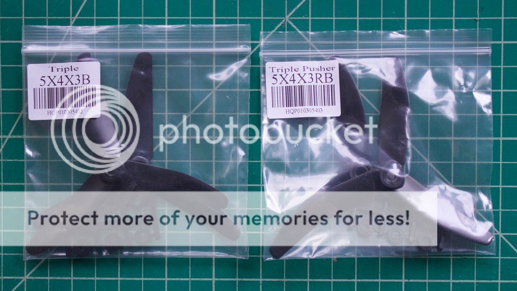

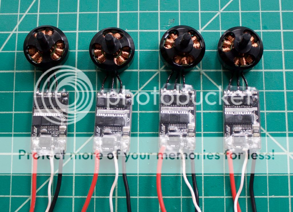

I'm going to run Cobra 2204 2300KV motors and KISS 30A ESCs. I'm going to try out the HQ 5x4x3 props.

thanks for posting the pololu package.. i went to there webapge and ordered 2 of them so i have them on hand for my projects. its sad when shipping cost as much as one of them.. sigh. so i bought 2 of them for 13.89
money sucks.. at least you know you are getting a quality product with the pololu tho.
