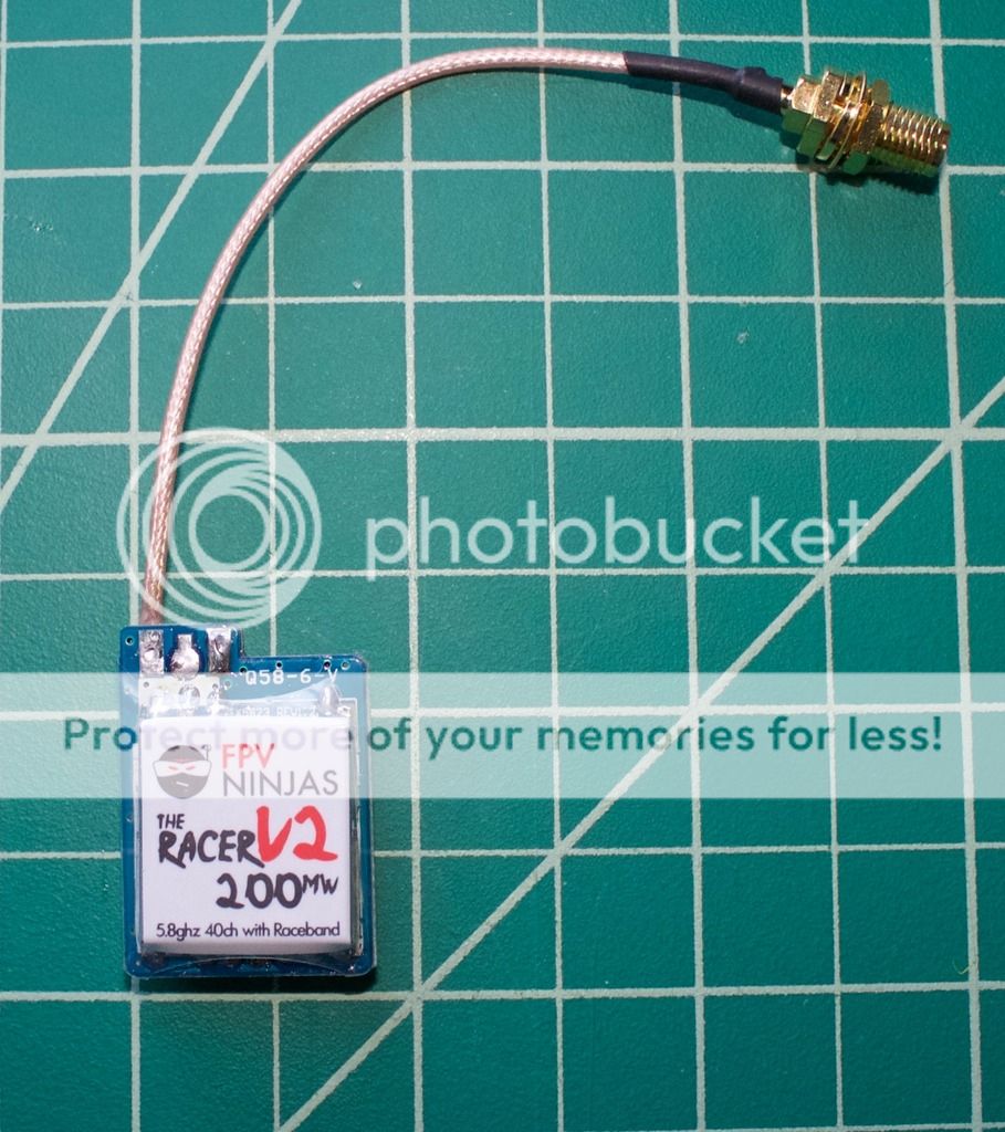

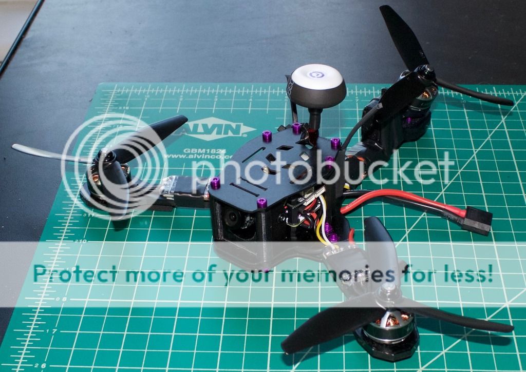

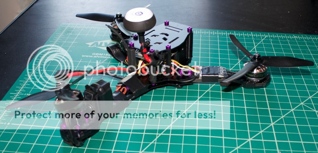

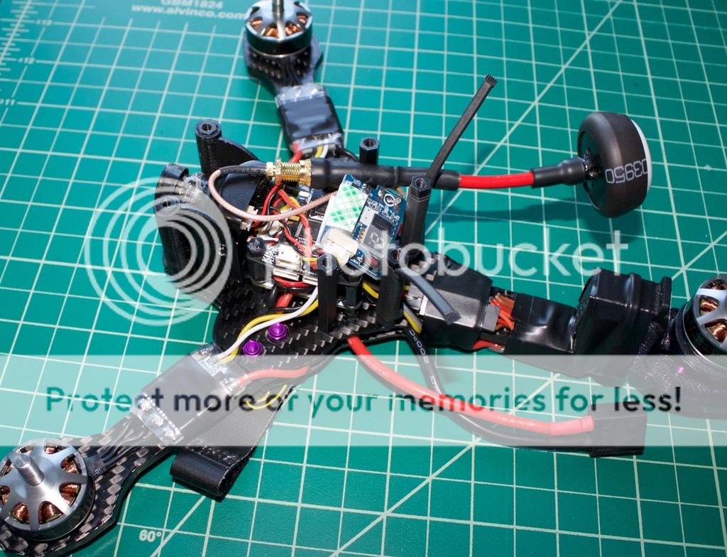

C0d3M0nk3y Posted a thousand or more times Apr 23, 2016 #143 I'm using a vtx from fpvninjas with an SMA pigtail. Here's what it looks like with all of the FPV gear installed: And here it is assembled:

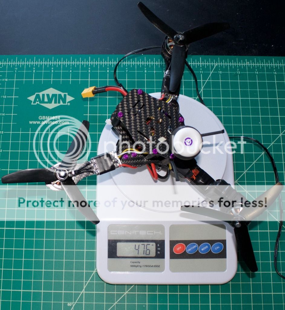

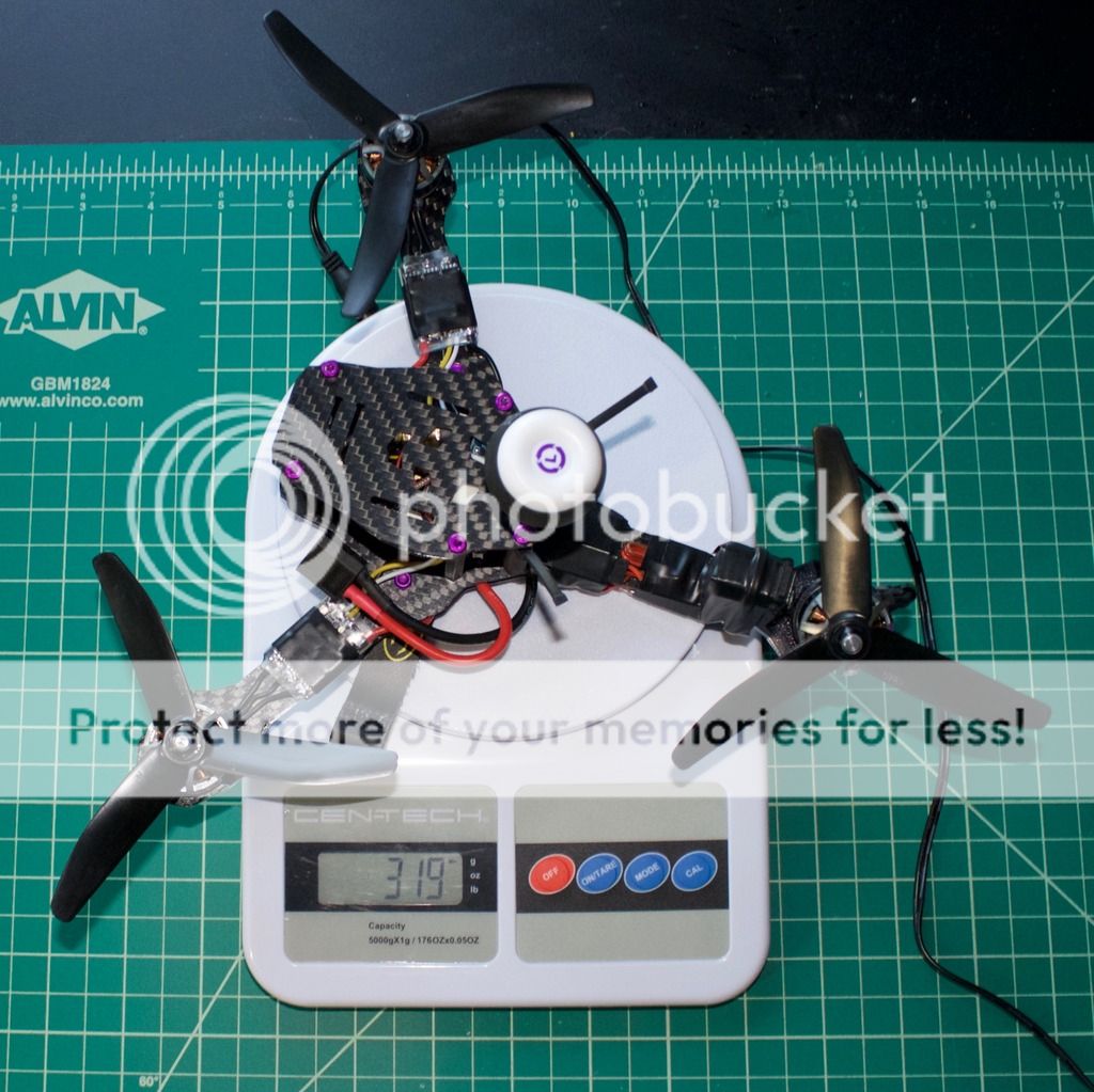

C0d3M0nk3y Posted a thousand or more times Apr 23, 2016 #144 The dry weight is 319 g, and the AUW with a 4S 1300 is 476 g.
Twitchity Senior Member Apr 23, 2016 #145 Man Code, I don't think you could fit anything else in there even if you had to. The tri is looking great!
