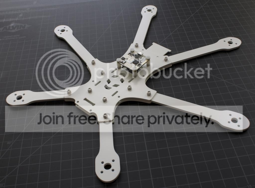

It will be a little while before I have the parts to complete this build. I did a quick assembly of the bottom plates and booms to get an idea what this hex will look like in the mean time.
cranialrectosis
Man that is sharp! Get some white heatshrink and use white Arduino wires for servo wires.
Whatever secondary color you use is gonna POP!

The hex looks even better now that it's together for that picture. Have you run into any problems/complaints about the frame yet, or does everything look good to you so far? This is the exact same design cranial has but in G10 and not CF so hopefully you won't experience any issues.
Everything has been good so far.

That white looks so awesome! That is such a cool advantage of G10 over CF :D
The white does look killer, I'm also sick of all black multis!
But...to be fair...CF can be painted. People just don't like to because that's kind of half the point of going CF on most of these designs - to get the "CF look". And even when it is a design that does take advantage of CF properly people don't tend to like painting over it because they paid for the CF and want to show off that it really is CF :D
And of course painting over black is a big pain to do well!
